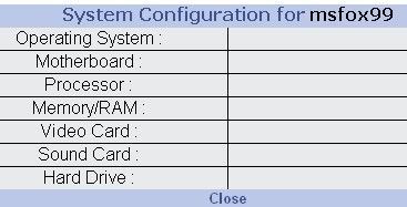

Please view:msfox99 wrote:Thanks for the replies. Per request, more info:
Motherboard: Asus P5K-E with Intel P35 chipset
CPU: Core 2 Duo E6600 2.4 GHz
DVD Burner: Lite-On LH-20A1P (also tried an NEC model)
RAM: 2 GB DDR2
Video card: nVidia GForce 8500GT
Hard drive: 4 misc hard drives
etech - there are no yellow ! points in the device manager. Please note that all my other burning software, as well as Vista, see the drive fine. It seems to be something unique to Ulead's burning module. I installed all motherboard drivers for the new board.
Thanks again for any help.
How to Complete your System Properties on this Forum
