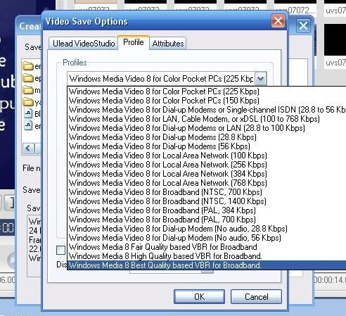

I can't seem to find neptune Best Quality, this is all the options I have for wmv:
I'm using ulead VS 11, but it's the trial version, could that be why? :/

I came across the same thing a short time ago...
What you need to do is download and install the Windows Media Encoder 9.
Download From Here
Download From Here

Thanks that did the trick!vidoman wrote:I came across the same thing a short time ago...
