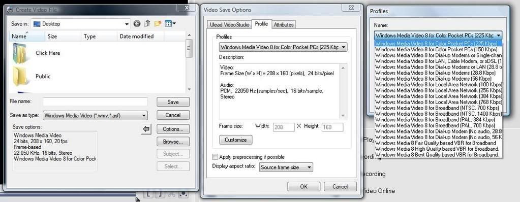

NOT WORKING
Hi there,
Still cant get WMVHD to be created. I cant help but think that some things are not included in the trial download because it looks like the profile for WMVHD doesnt even exist. Can anyone confirm that this should work fine on Windows Vista 64 bit???? I cant buy this if it doesnt do what I need. Thanks!!!!
AccessDenied
I am having this exact same issue. Ulead will simply not allow an export of any WMV video other than in the pocket pc or broadband format. This is extremely irritating for me. I just finished editing a video that took a good 20+ hours of work to create, only to realize that now I cannot export the movie in the format that I need.
I am running a vista 32bit machine, is this a vista only problem? Are any other trial members (running xp) getting the same issue?
EDIT: Available profiles listed in Ulead Custom WMV sharing options
AccessDenied

I don't think it's the Vs11+ program, when you go into the options or advanced sections for producing a HD-WMV video you should definitely see the Windows Encoder Series Version 9
I don't understand why this isn't installed during a Vista installation.
Search on the MS website for "Windows Media Encoder 9" package.
Download the package and install it. Then when you go into this screen posted above you will see the HD templates. You should customize your own anyway.
I think this is it but not sure, I thought the package was bigger, if using Vista make sure to read the provided links by MS. They have additional patches for vista and HD-WMV encoding.
http://www.microsoft.com/windows/window ... fault.mspx

Resolved MWVHD Export Issue!!!
Guys thanks for your suggestions,
It works. Thanks to etech6355 for sending me down the right path. In Vista (for some reason) you have to install the Windows Media 9 Encoder. The ONLY think you have to install is the encoder. The URL is as follows:
One caveat, even if you have Vista 64 you still need to download the 32 bit version. I installed the 64 bit version first but Ulead does not "see" it. I uninstalled it and then installed the 32 bit version. Now eveything works GREAT!!! Thanks again for all your help!
