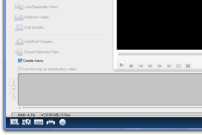

First, I start a project with the settings at 16:9:

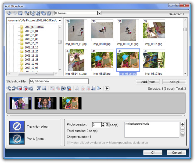

When I view photos in the slideshow window, I see them in a 16:9 box (which is good):

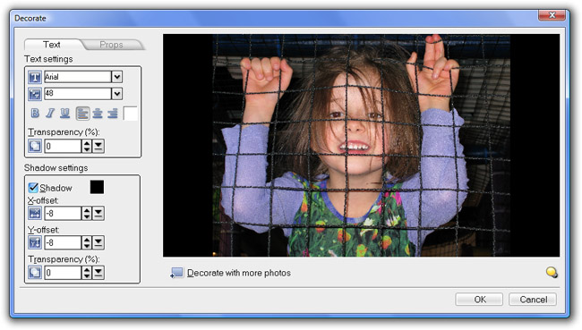

When I view photos in the Decorate window, they are shown in a 16:9 box (which is good):

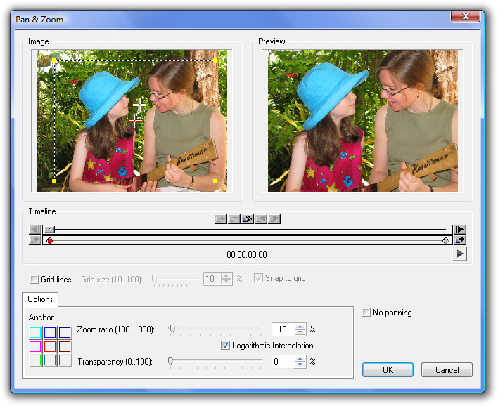

But when I view/edit photos in the cutom pan and zoom window, I see only 4:3 boxes and the pan/zoom guide frame is also 16:9. I think this may be a problem - unless I have missed a setting somewhere.
Thoughts?
Thoughts?

I guess the preview screen in this module could be 16:9. Not really a problem for my editing needs. When you return back to the slideshow creation screen there is a play icon right above the pictures timeline. You can preview the true 16:9 framesize there.But when I view/edit photos in the cutom pan and zoom window, I see only 4:3 boxes and the pan/zoom guide frame is also 16:9. I think this may be a problem - unless I have missed a setting somewhere.
Really depends how picky you want to be. I use this zoom feature anchored to the middle of the screen without any movement. This will zoom the 4:3 to fit nicely into a 16:9 display and keep the correct proportions.
133% is the normal percentage for zooming a 4:3 picture to 16:9 and fill the 16:9 screen correctly, maintaining the correct aspect ratios.
