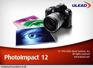

Ok so I just downloaded the Free Trial for PhotoImpact 12 and the icon is on my desktop and all. But the problem is when I open first window
^ this window
I click the try button and this comes up
for like 30 seconds and then nothing follows it, it just stops and the window leaves
Can someone help by telling me what's going on and how to fix it so I can use the free trial?

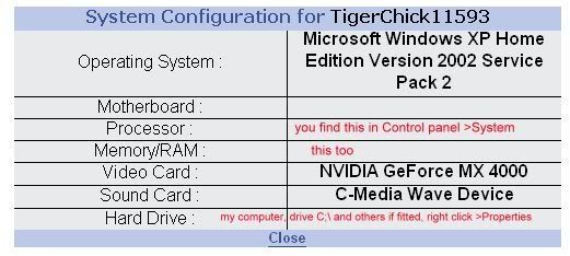

Please click here --> Image so that we can then view your system specifications.

alright so i tried the system thing, but i couldn't fill out the whole thing becuase i was kinda confused. And i don't know if i even filled out what i did fill out, the right way.
heinz-oz
Post by heinz-oz »
Good start, now fill in the rest please.
TigerChick11593
Post by TigerChick11593 »
Ok I filled out more, but (not to be mean) but what is this doing to help my problem? Is my problem a common problem? Is it fixable?
I guess questions like these were y this forum was made. Well I hope we(mostly you guys) can get to the bottum of this.
Thanks for the help so far tho!
heinz-oz
Post by heinz-oz »
Something is stopping your PI from starting up. If we don't know anything about your system, how are we going to be able to have a guess at why this happens?

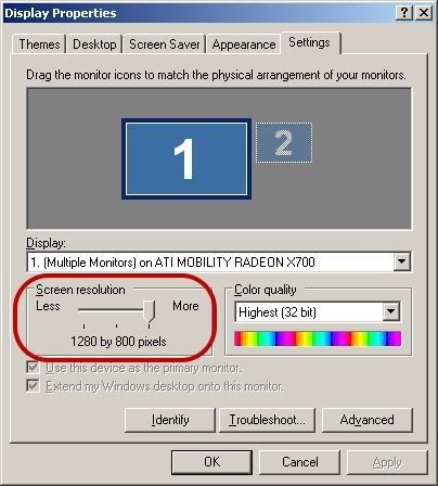

Right click anywhere on your desktop (monitor screen) while the desktop is shown, not when you are on a program interfeace. Click "Properties" in the little window popping up and then click "Settings".
Please tell us what is listed in the marked area?
Another possibility, happened recently to another user, is if you have a large tiff image in your "My Documents" folder. Aparently PI looks at the My Doc's folder when it loads. if you have any tif or tiff images inside that folder, move them to a different location until we have eliminated these as a source of your troubles.
TigerChick11593
In that area of mine it is: 1024 by 768 pixels

In the bottom of the splash screen when PI is loading, it shows what files are being loaded. Just prior to crashing, what is the file that is being loaded? This may help us in figuring this out..
Ron Petersen, Web Board Administrator
TigerChick11593
the only thing that comes up is this. Then it leaves the screen and nothing happens.
