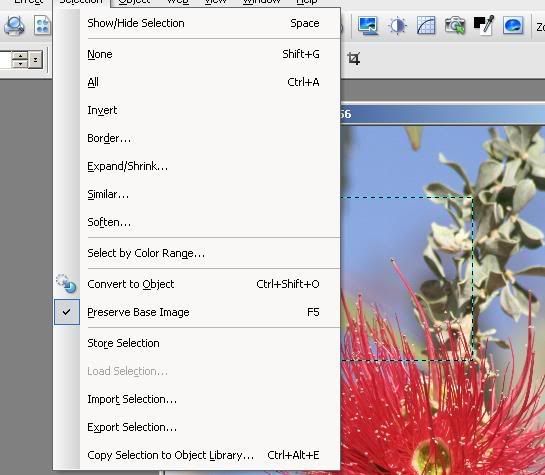

Post by heinz-oz »
What type of source image? It usually works and looks like this

heinz-oz
Post by heinz-oz »
Yours is not a selection. You have just created a shape. The properties of that shape are modified in a different area, the tool bar just above the work space and in the tool setting area on the right hand side where the EP resides.

heinz-oz
Post by heinz-oz »
I'm glad they don't more often than not. You need to use the selection tool to create a selection on which you can use the option found in selections. A shape you just drew is not a selection, it is an object or what you would call a layer in PS. In PI you don't need to create a new layer. Any object you create or import automatically is a new layer.
