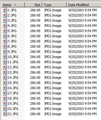

I just created a folder that contains the following (21) file names 1.jpg, 2.jpg, 3.jpg....9.jpg, 10.jpg, 11.jpg....19.jpg, 20.jpg, and 21.jpg. No matter what view I use (details, list, etc) they stay in order. I then imported all 21 images into a project by using Crtl+A to select them all and they all came in 1-21. Just for grins, I changed the Details view to list them 21-1. Using Crtl+A, they all came in in reverse order (21-1).Bobm03 wrote:Your numbering system has to have consistency in the 'number" (sorry) of digits.
If going from 1 to 99, (two digits), use 01,02,03....09, 10...99
If going from 1 to 418 (three digits), use 001, 002, 003,...099, 100....418.
You just have to think like your computer does.
