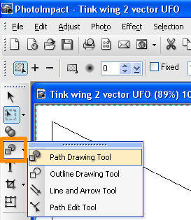

Here is where the path draw tool is in PI-12.
(all screenshots can be clicked to enlarge)

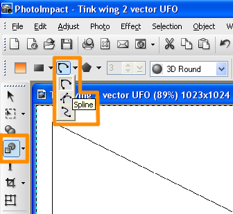

Select which means of path drawing you want. Spline traces the curve along your points so as to minimize eccentricity, like the shape a rod of spring steel would assume. Bezier will connect your points with straight lines.

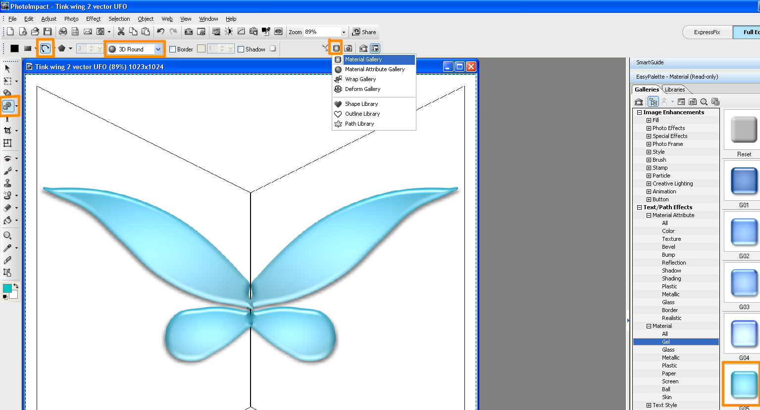

Here is where you select 3D effect and gel material for your object.

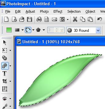

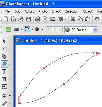

This is a spline-drawn path. I used spline to get the graceful curvature of a pixie's wings, but to get the cusp (the sharp point) at the tip, you need to put a couple of points very close together.
When you finish the complete path, double-click on the same spot as the first point, and the path is converted to a 3D gel object. Instant pixie wing!

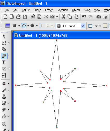

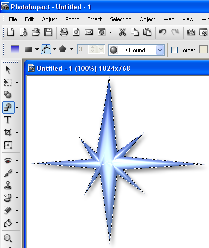

Bezier is good for angular objects, such as a glitter starburst.
Finish the path and double-click. Instant glitter starburst!
