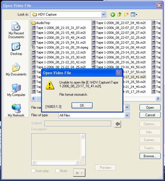

Hi,
I have captured with a litle app called HDVSplit and have a heap of .m2t files. When I try to add them to the clip library I get a file mismatch error. See below...
Can I somehow import these files or do I have to re-capture through VideoStudio 10?
I can import them ok into Premiere.
Any help would be really appreciated...thanks.
Joel

Sorry, but, IMO, the worst thing you can do with high definition is to capture with HDVSplit into a zillion little files, all re-rendered, and placed in a format that was designed, not for playback or editing, but packetized to transmit video from place to place reliably (Transport Stream, .m2t files).
You will get much better results by recapturing the original encoded mpeg2 HDV Program Stream (.mpg files) directly, using Video Studio 10+. Check out the high definition tutorial at http://phpbb.ulead.com.tw/EN/viewtopic.php?t=13872
Edit: If you really want to split your video by scenes, the right time to do it, IMO, is aftter you capture the video and without actually altering the capture video file. You can do so on any HD video file, in 10+, by placing it it the edit timeline and selecting "Split By Scene", which will "virtually cut" the file, without rerendering, into separate clips, each of which can be further manually trimmed for the final output.
