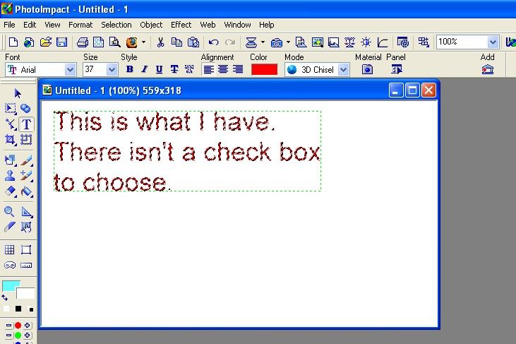

Still no luck..here is a SS of what I do have.

Okay, the Border is in a different location for PIXL, sorry my error!!!
On the Tool Options Bar, click the icon named Materials to call the Materials Properties dialog box.
Select the Tab named Border/Depth to add a border to your text. Make the necessary changes and apply your settings.
