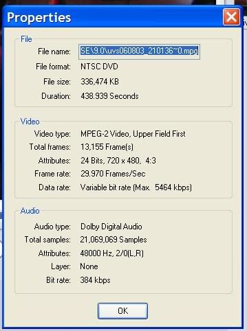

Leviathan1956
Thank you for the response, Vidoman. I right-clicked on my imported from DVD clip, and that is what was shown to me.
I found another answer back on page 7 or 8 that explained that VideoStudio 9 SE (which is what I have) doesn't support Dolby audio? Is that what the problem is?
Also, no I don't have the MPEG-4 plugin. I don't have any plug-ins... should I have?

Since you are using an SE version it does not support Dolby Digital, and you are not going to be able to install the MPEG-4 or HD plug-ins. They are for the full registered versions.
So for you to be able to use the audio, you would need to convert it to MPEG audio or LPCM. Or you could upgrade to VS10 Plus, SE versions do qualify for the upgrade price. VS10+ does support HD, MPEG-4, Dolby 2.0 and 5.1 surround.

You could also try installing this free Dolby AC-3 filter from http://www.videohelp.com/tools?tool=AC3_Filter That should at least allow you to import your Dolby audio, but it will not allow you to re-encode that audio outwards as part of a new project. You would have to convert it to either LPCM or mpeg layer 2 audio.
