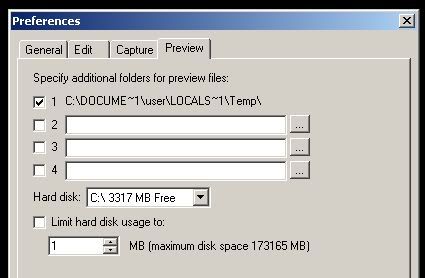

Is this the location of my temp directory?
The wording didn't sound like it but it's the only thing that lists a path in my preferences or project settings. Anyway, there's not much in it so I don't think it being full is the problem. I deleted all files anyway.

You should set your VS9 temp directory on a drive other than your OS drive. You only have 3GB left and the file you are creating is many times the size.
Also in VS9 change your preferences, working directory to a drive other than the OS drive (it's usually set at the same place as your temp directory)
Make sure you are saving your files to a drive other than your OS drive.
You also need to clean your OS drive, remove your temporary files and any programs you don't need.
Your swap file needs to be move to another drive also, since Windows is taking 1.5G of storage space on your OS drive.

tyamada, I have set my temp directory to my video storage drive. I've set my working drive there also. That's where I save my files too. What is my swap file and how do I move it? Does it seem weird to you that I could complete another project with no errors, using the exact same settings (temp file locations, drive settings, etc)?
