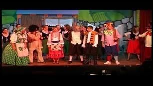

OK, this is what it should look like....
But this is what it actually looks like:
When the bottom frame grab is viewed on a 4:3 set, it is the same width as the one above it but with black bars twice as thick. Hope that explains it.
I have project properties set to 4:3 AVI and footage looks fine when being uploaded onto PC but when played back, it goes all crappy and in properties, it says it is 16:9. Also says 16:9 in project properties even thought I'd had it set to 4:3. Changing this makes no difference.

Ah sure not to worry. I wouldn't mind but the camera is not even proper anamorphic widescreen camera - just letterbox black bars. So why there is a widescreen flag has me perplexed.
