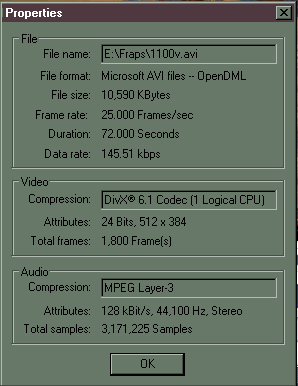

Here's a screenshot of one of the movie's properties. http://img.photobucket.com/albums/v647/ ... erties.gif

Yes, well, that confirms a couple of things.
In the first place, DivX files, though they use an .avi extension, are really a variety of mpeg-4 file, which is highly compressed though of good quality. The thing is, though, that Video Studio 9 can only handle them with an optional free plug-in which is only available to registered users i.e. not available with the trial version. So in effect, you cannot do anything with them with the trial version of VS9 and without the plug-in.
The fact of the matter is also that by converting your original huge files to DivX, you have already altered their quality. DivX is highly compressed to make resulting files very small, though as I say, it retains a very good quality. But that doesn't alter the fact that mpeg-4 is a (very) lossy format, and thus loses quality every time you render it. I confess that I don't even know if Smart Render works via the mpeg-4 plug-in. Maybe someone else could answer that point...
Which brings me on to my third point. Just how 'huge' are your original files? (The image you sent, though useful, is of a converted DivX file, but I would like to know about the very first originals.) Does five minutes of video take over 1 GB of space or over 5 GB? I ask because I don't know anything about this FRAPS program you used to record your gameplay. I suspect, though, that it may allow recording in full, uncompressed AVI format (65 GB an hour), instead of the special compressed, but not lossy, version of AVI called 'DV' (which is used by most modern digital video cameras). The point is, though, that you will only retain the original quality if you retain the original format -- either the uncompressed full AVI (which of course presents space problems), or else convert it to DV format, if this indeed can be done.
But it also depends on what you eventually want to do with all these files. Do you eventually intend to make a DVD of them? If so, then you have also chosen the wrong codec to make a DVD. DVDs made with mpeg-4s are possible, but there are only a tiny number of stand-alone players that will actually play them, though this is likely to change in future. The standard DVD file format is mpeg-2. So if indeed your original is uncompressed AVI, and you need to conserve hard disk space by converting it, then I would be converting it to high quality mpeg-2 format with DVD settings. You could still edit the parts you want to change the speed of in AVI format, but then convert them also to DVD-compliant mpeg-2. And then you could join them all together and use Smart Render as per my original post to you. Mpeg-2 files are of course much larger than mpeg-4, but one hour of mpeg-2 at the highest DVD quality settings will still only be around 4 GB.
